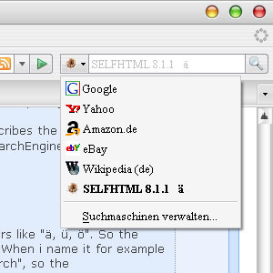

 文章主題 : I found a bug
文章發表於 : 2006-11-05, 04:49
註冊時間: 2006-11-05, 04:37
Sry, i am from germany and i only speak a little bit english.... i hope you understand my "bug report"
When i want to add a SearchEngine to the bar, and the SearchInfoField, who describes the SearchEngine (Name), contains a DescriptionName with "ö, ä, ü" you are not able to add the SearchEngine as DefaultSearchEngine in Firefox.
Here you can see the Bug:
In "about:config" the string: "browser.search.selectedEngine"
does not contain any Information when i describe the SearchEngine with characters like "ä, ü, ö". So the GoogleEngine, which is the DefaultSearch is selected by the next start of Firefox. When i name it for example "CNN.com Search", the string in "browser.search.selectedEngine" is "CNN.com Search", so the CNN-SearchEngine is selected by default........
I hope you understand my bug ^^
sry for my baaad english :)
My second >bug< is, when i add a searchEngine to the bar, after i push the button >forward< there is written; "... please restart Firefox to add the Engine...." but I think this is not necessary any more!
perhaps you can answer my post in english and not korean or something, so i can read it too :)

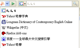

文章發表於 : 2006-11-05, 10:19
註冊時間: 2005-08-29, 15:40
文章: 236
Er4z3r 寫:
Could you report which site you cannot make search engine by this extension, please.
Does the form.action look like "http://xx.xx.xx/xx.xx?xx=xx&xx=xx"?
I know OpenSearchFox 0.0.0.2 cannot work well if the form.action looks like that.
"browser.search.selectedEngine" cannot show chinese words neither, but you can add search engines which name contains "ö, ä, ü" or "中文字".
Er4z3r 寫:
I know that, the new translation will be used in next version OpenSearchFox.

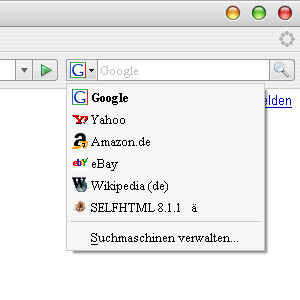

文章發表於 : 2006-11-05, 21:39
Milx 寫:
Sry, but i tested it only a few days and all searchEngines i added worked fine for me, i also noticed that sometimes i was able to chose between searchfields on one site (VERY GOOD!!). Can you explain where i can see the "form.action"? So that i can compare it.
Milx 寫:
Yes, I do. So it must only be allowed to show "browser.search.selectedEngine" also chinese words and "ö,ä,u,?". So the SearchEngines COULD be the default SearchEngines after a Restart of Firefox. Is that right?
The images showing the "before" i restart my browser, and "after:
圖檔 圖檔
You see, that SearchEngines named by "ä" can not be the default search engine (after restart).

文章發表於 : 2006-11-05, 21:53
文章: 236
Er4z3r 寫:
Milx 寫:
圖檔 圖檔
That's nothing to do with OpenSearchFox.
Firefox2 will show the first search engine in your list whenever you restart it.
Like "ö, ä, ü" in my pic and "Google" in your pic.
